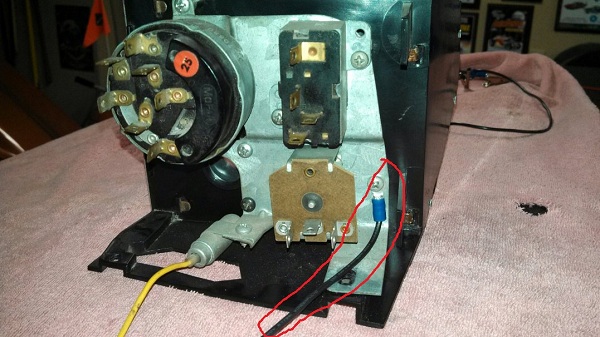

C'est le bon moteur. Plusieurs facteurs font que ça peut déconner.
Une bonne masse entre l'interrupteur de commande et le tableau de bord. Rajouter une masse ici.
Jules avait fait une vidéo montrant l'intéret d'avoir une bonne masse à l'inter de commande.
video
Comme dit Kim, bien vérifier l'état des bras d'essui glace, pas de dur mécanique, de rouille. Nettoie ces bras et met un poil de graisse sur les points de rotations.
Essai de faire un film pour voir la cinématique.
As tu aussi la possibilité de faire une photo de ces bras pour savoir si ce sont les bons.

Perhaps further information that might help.
Since the motor is for an E body I would assume the clocking/timing is good. I can't quite ascertain if the motor attempts to park and "binds" or if the position in the photo is it's final resting position after the park cycle is completed.
If this is the case my instincts would be that the linkage is not allowing for full range of motion, although it could be the incorrect crank arm also. The transmission crank arm attaches to the back of the wiper motor and then goes to the linkage. The correct PN should be 2822289.
You might also check the transmission link that goes from the passenger side of the car to the driver's side pivot and make sure that part number ends with 293. If the car has a two speed drive link that can also be causing the problem.
We get these cars in such varying degrees of disassembly, prior owners who made changes that we're unaware of, etc. that it can be simply some incorrect components in the scenario that once recognized and replaced, the function of the wipers is as it should be
