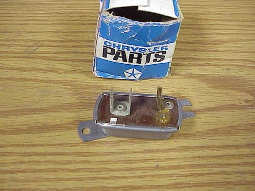

ca serait pas ton voltage limiter d'instrument qui serait grillé ???
Image Image
http://www.ebay.com/itm/1961-Plymouth-Fury-Belvedere-NOS-MoPar-Voltage-LIMITER-/350023235159?pt=Motors_Car_Truck_Parts_Accessories&hash=item517f02b657&vxp=mtr
ou
http://www.ebay.com/itm/INSTRUMENT-CLUSTER-VOLTAGE-REGULATOR-VRC601-Standard-Motor-Products-/380404627410?fits=Year:1966|Model:Belvedere&hash=item5891e1f7d2&item=380404627410&pt=Motors_Car_Truck_Parts_Accessories&vxp=mtr
