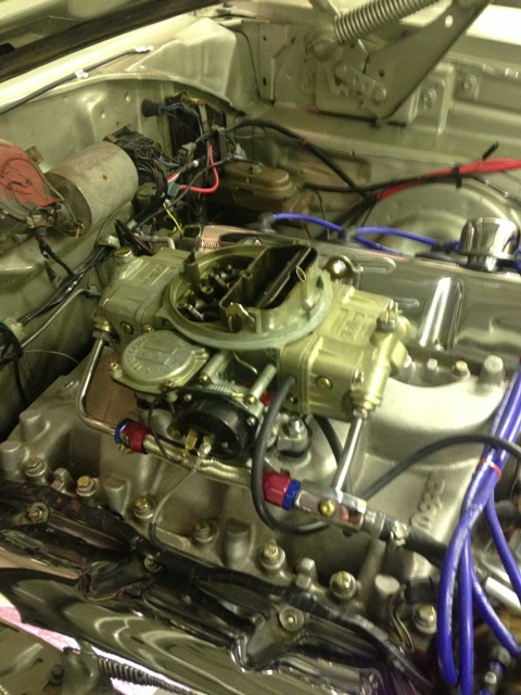

it is a true Hemi? you have pictures ? :whistle:

Yes it is a real hemi. Attached picture. We are changing the intake back next week to 2-4 barrels like it used to have the 1-4 barrel is just not good. Image

The Hemi engine runs very hot and eats spark plugs like candy. The picture above is older. We have now changed the radiator to a custom aluminum radiator with 2 electronic fans. If running a Hemi run the original Champion N10Y spark plugs, not the expensive platinum plugs-the platinum plugs foul very easily for some reason. We did change it over to a Mopar electronic ignition because the old dual point distributor is so hard to keep set.
I keep the engine tuned to start easily-very retarded timing. You can advance the timing with the Hemi to easily pick up 75-125 horsepower but it is very hard to start and the tires burn off. When we have it advanced, even if you are doing 100KPH and stomp on the gas pedal the tires spin and the car turns sideways-very dangerous except on open roads. We live near the farms and have lots of open roads to test the tires!

great !! very interresting by all what you say , i confirm about the plugs !!! the hemi is a plug eater !! when you had a single carb what was it ?? i have a ray barton intake with at the beginning a single Holley 750 cfm now a 850 ( not sure yet that he's well tuned ) and what advance do you have ?? they put on my engine a timing at 30 and what rear end do you have ?? thank you

What you gonna put carburetors as the Hemi? of AFB Carter ? :)

Carburetor: The old Carburetor was mounted on a standard Mopar Hemi dual plane aluminum manifold. It was a Holley 850. I will go to the shop Monday and can get a picture of the current manifold and carbs-I have it off right now anyway because I am doing some work on the heads. It is Mopar aluminum dual plane, dual carburetor manifold that has the Vanke modification and runs dual Carter AFB carbs at 600 cfm each. It is much more drivable and no hesitation or fuel issues. I will have to wait on telling you what the timing is set at because I will not have the car running again for a week or so while I replace the wiper motor, valve covers and put the intake manifold on it. I will post a picture of the manifolds and carb once I get to the shop.
